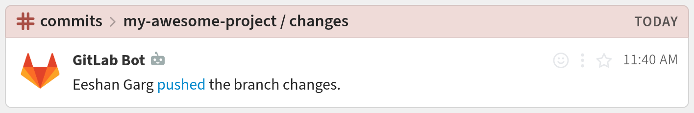

You're done! Your GitLab notifications may look like this:
