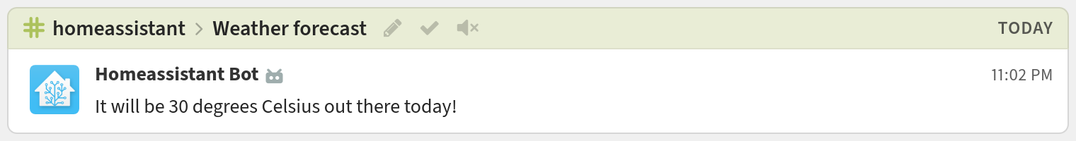

You're done! Your Home Assistant notifications may look like this:
