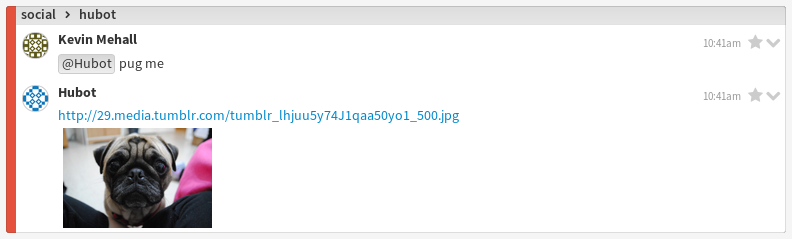

To test your Hubot installation, send it an @-notification with a
basic command, e.g., @Hubot pug me, which should produce a
result like this:
