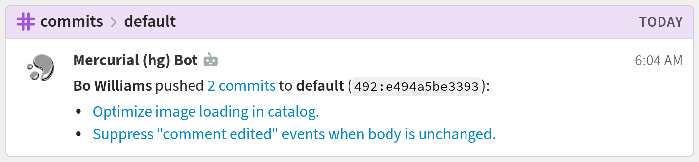

When team members push new changesets with hg push, you’ll get a
Zulip notification.
You're done! Your Mercurial (hg) notifications may look like this:
