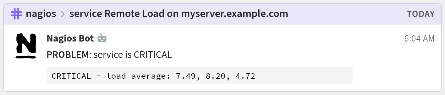

  8. When your Nagios system makes an alert, you’ll see a message like the following, to the stream nagios (to change this, edit the arguments to nagios-notify-zulip in /etc/nagios4/conf.d/zulip_nagios.cfg) with a topic indicating the service with an issue.
You're done! Your Nagios notifications may look like this:
Nagios bot message
