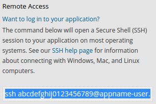

  4. After that, connect to the application through SSH. If you don’t know how to do this, log in to your OpenShift Online account, go to your application’s dashboard, and click Want to log in to your application?. There you’ll find the app’s SSH user, address, and further information on SSH, in case you need it.
    Connecting to application

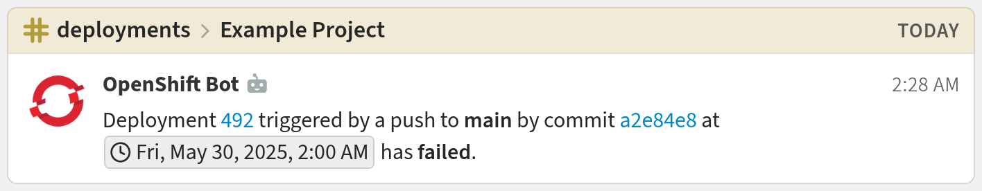

You're done! Your OpenShift notifications may look like this:
OpenShift integration message
