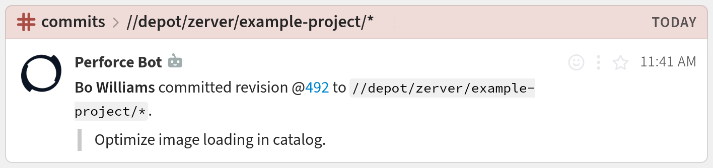

You're done! Your Perforce notifications may look like this:
Perforce notification bot message
