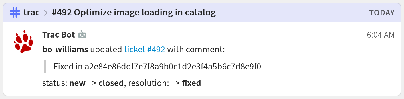

  8. When people open new tickets (or edit existing tickets), notifications will be sent to the stream trac (or whatever you configured above) with a topic that matches the ticket name.
You're done! Your Trac notifications may look like this:
Trac bot message
