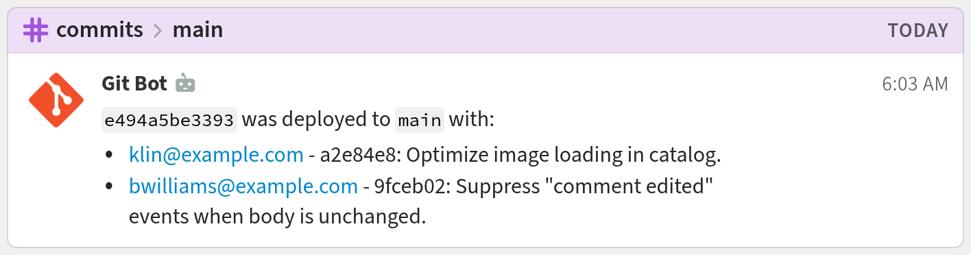

You're done! Your Git notifications may look like this:
